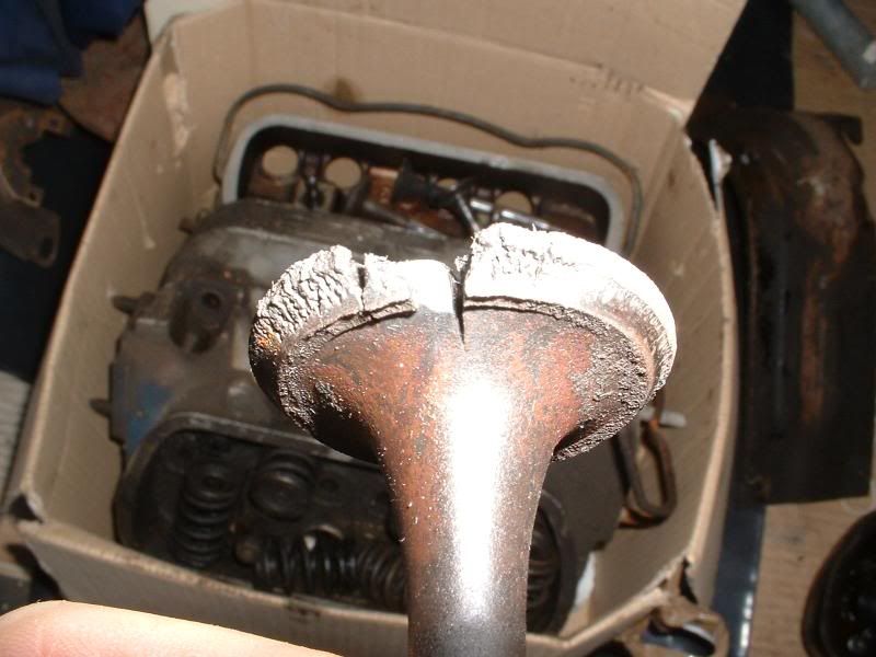

Take a look at this exhaust valve, probably as a result of bad mixture, valve clearances or timing, left much longer this could seriously ruin your day and your engine! Early symptom would probably be massive loss of compression and smoke! Don’t ignore the symptoms :D

Oh yes.... It's a beauty :wink:
